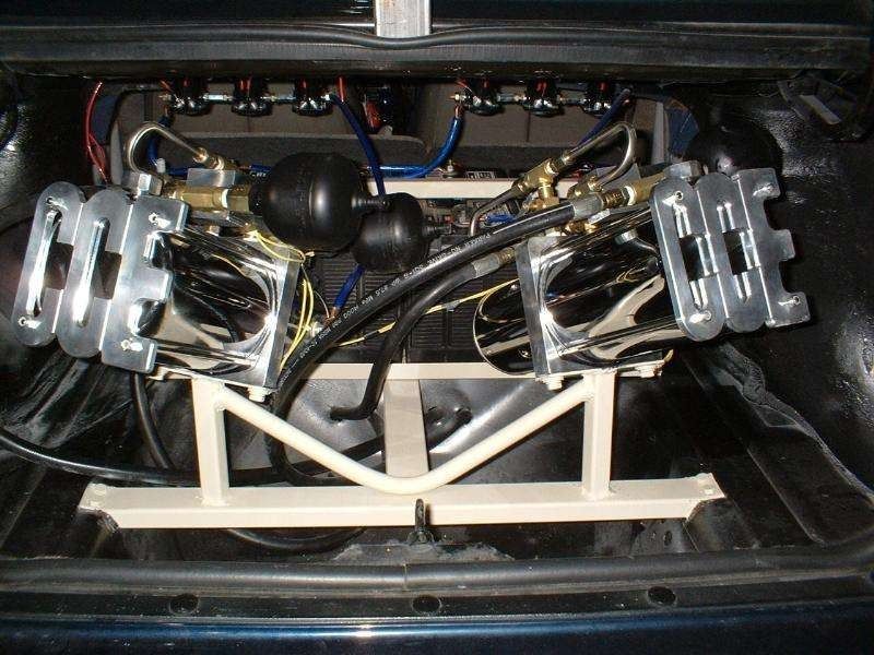

I've built a Mcpherson strutted Saturn in the past. You're only going to get it to lay by doing one of two things. Either ditch the strut bags and go with cylinders or ditch the air all together and go with hydraulics.
I first bagged mine using air cylinders. They were junk. In less than a week 1 broke in half and the other 3 bent. This is caused by the way they sit at somewhat of an angle. Sure it laid out nicely but it only lasted a week. I sold the air and went with a 2 pump CCE setup and had zero problems out of it. IMO, juice is the only way to go on a mcpherson strutted car. As long as you have accumulators it rides great.

I was thinking the same thing... could anyone post a link to where I could get info on either to buy or build a macpherson hydro strut... I think I'll keep the air for the season and try to get some hydro stuff for the 09 show season.

yep i say hydros as well
