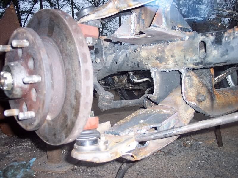

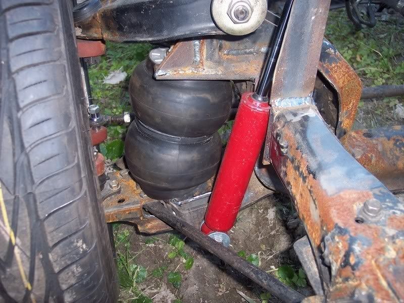

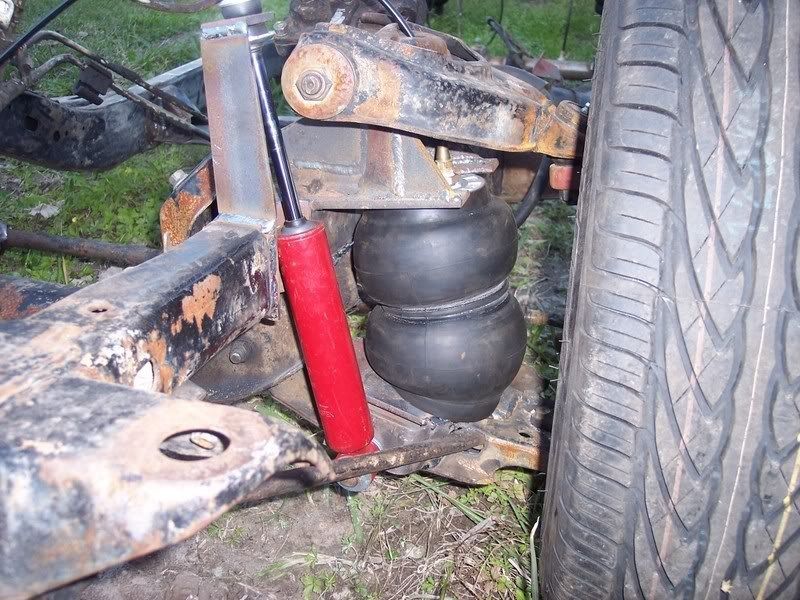

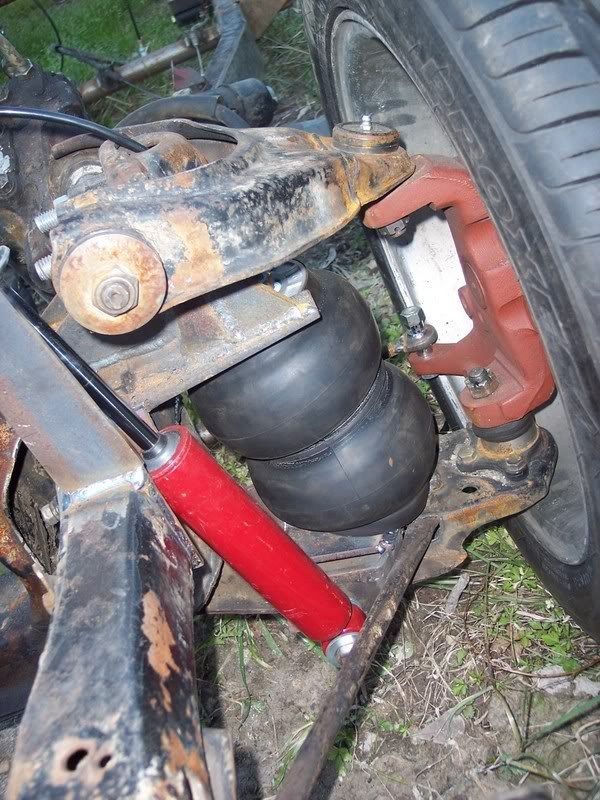

the front of my old single cab...had upp floating cupsall we did we cut the pocket and weld a plate to the lower arm...upper balljoints were reangled

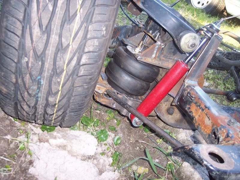

my extra cab...torsion brackets
hope this helps....if u need nething else hit me up. i got TONS of pics
