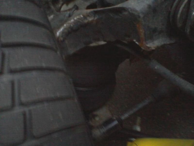

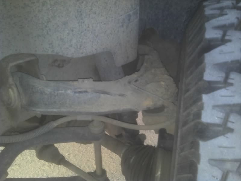

I really dont want to sell it but I wont turn down 15k. The uppers have weird c notches for wheel clearance. Kinda scary looking. Shoot me a cell # and I will send pics.

here is a pic of his top a-arms. the previous owner cut big pieces out of the sides so the wheels wouldn't hit the arms.....
since this is a 2001 dually. is it supposed to originally have some tubular a-arms ?
Post was last edited on Jan 14, 2012 10:01. Edited 1 time.
sparkys-crewcab
... after a quick search on ebay. this truck is supposed to have some tubular top control arms from the factory.
looks like they used all the parts off a older squarbody 3/4 ton truck. (hubs and the top control arms)...ive never seen anybody do it like that before...
