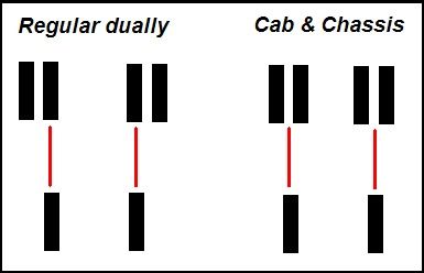

Sounds to me like you've got a chassis cab rear axle (narrower than standard dually) in there...I made this simple diagram that should help you figure that out, just look at how the front tires line up with the rears:

i thought it was c&c but what about gap between cab and bed ? how do you fix that ? thanks for replying

Chassis cab wheelbase is usually 4" longer than a comparable regular pickup. Shorten the frame or do some serious bodywork to extend the bed...
