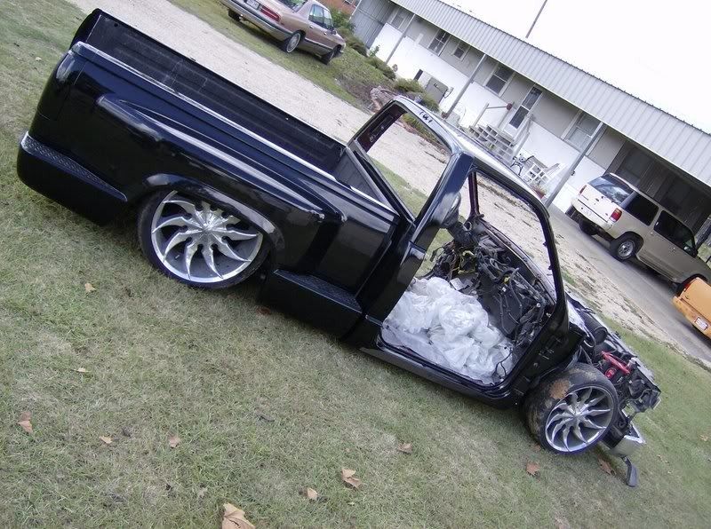

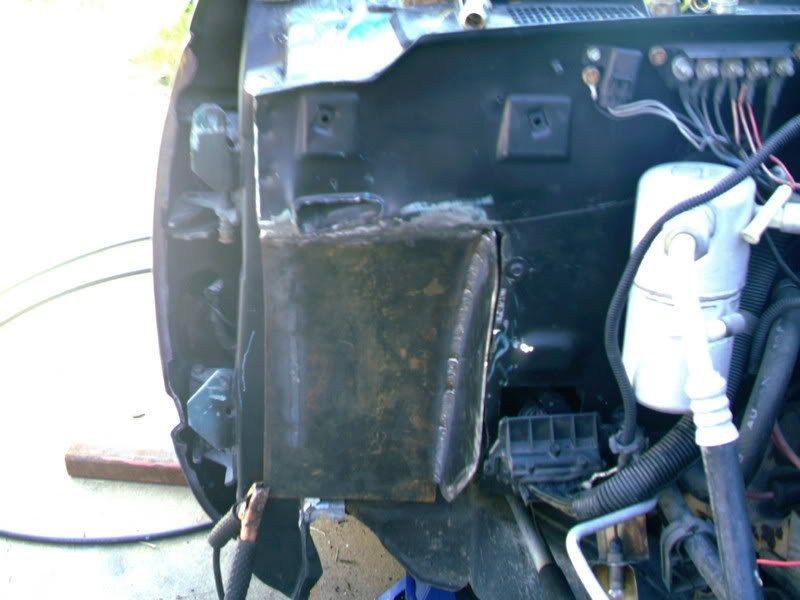

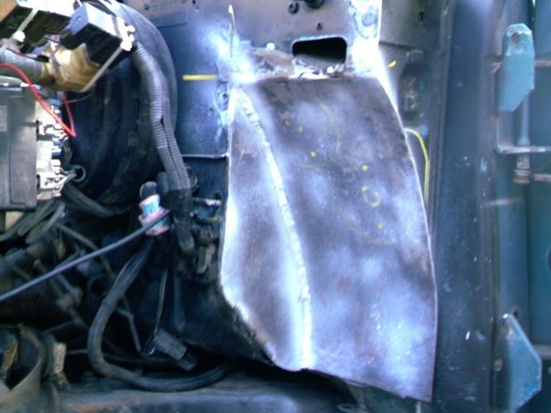

what do you want pics of man? the ones i mainly have are of the last one i did that we BD on 22s. what kinda wheels u lookin for? passenger tubdriver tub,u can see where the harness was and why it needed tubbed
lo75lux's avatar
lo75lux
actually that was after i moved the harness. it was about 4 inches over right where the tub is.

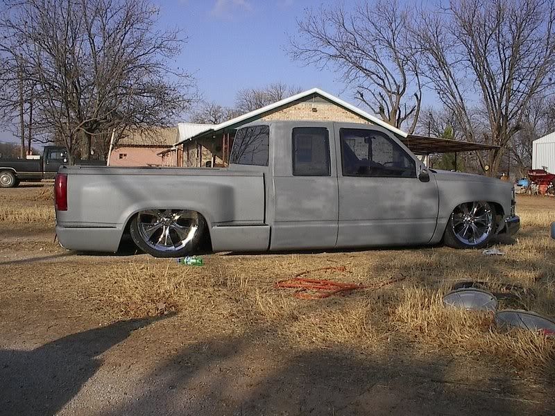

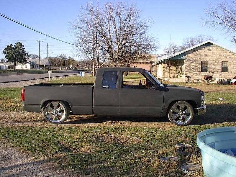

thats the lift ud get with 2 inch spindles and re6's in the front. or around there. gives u an idea. and the rear is a 2 link with bag on bars,and those are AIM bags in the rear.
lo75lux's avatar
lo75lux
with slams in the rear on that kinda setup u could prolly get 18-20 lift. i was gettin 16 outta those cheap aim bags at about 155 psi.

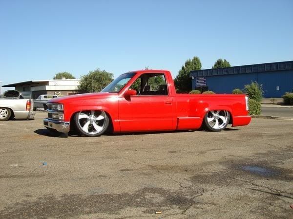

this is my buddies stepside and if i remember correctly yes he does rub a lil!
