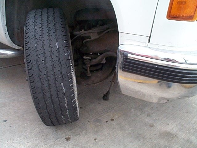

Man, those spacers look screwy. I'm no engineer but it looks like they'd want to break off just below where it goes in the spindle from the bottom. Maybe OK for a light car like a Mustang, but I wouldn't want that stuff on my dually. Having a tie rod bust off is no fun...ask the guy it has happened to (me)
Happened right after I jumped off hauling ass down the freeway, lucky me that was my '96 ext cab wrecker.

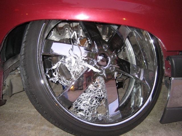

For some reason it seems like the ball joints like to come apart at low speed most often. I've towed more than a few people where the ball joint just popped in a parking lot. Man, it's a pain getting the boom under the truck when it's basically sitting on the control arm, and the wheel is flopping around.
Now this guy clearly wasn't as lucky when his ball joint let go, dig the birds nest of wheel shavings...
