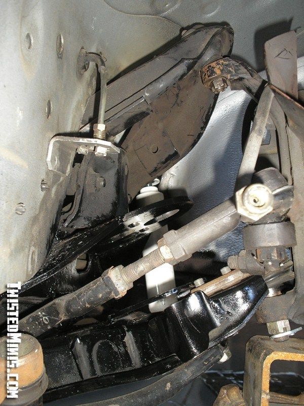

I keep posting this picture so I'm sure people are sick of seeing it, but I'd like to think its helpful. I did one with flipped ball joints and stock everything. All the component start to bind at the same point, but I was able to make it lay on a 225/45/17 tire, which is about the size of a 40 series 18.

Hey Seth. I know that being out of toyotas and under a Mazda is a little out of your element, like I am not under a Zu, butI cant tell in that pic, but is the upper ball joint aqlso mounted on the top of the upper control arm?
