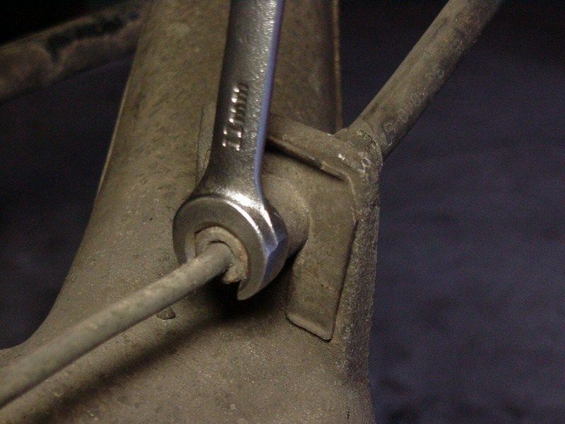

You are supposed to use flare nut wrenches on those types of nuts:
The flare nut wrenches have more holding power on the nut, kind of like a boxed end wrench.
Back it up with a flare nut wrench on the other side like was previously said.
