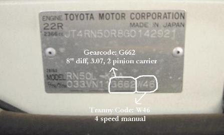

Are you sure about this Seth? I saw a site online where they went through the code on the engine bay and said that G662 (in that code) means 3.06 gears, or similar. It was right around there....

thats what i went by anyways, if i have 4.11's im fucked on the highway and need to find me some ??higher gears?? to get my rpm's down...

I'm not 100% positive. I have heard the 4 speeds have different ratios, and I know it differs by body style too. Pre 84 is 4.11 period, with no other options. My book said there where options for 3.73 with some 4 speeds, but it doesn't mention any other gear ratios. The best way to tell is put a mark on your tire and spin your wheel and count the drive shaft turns in one rotation of the wheel.
granth
ya mines an 85 so it may be different. i will have to do that and see what i actually have. id LIKE to have ~2.7x gears. because i love actually DRIVING to shows.
