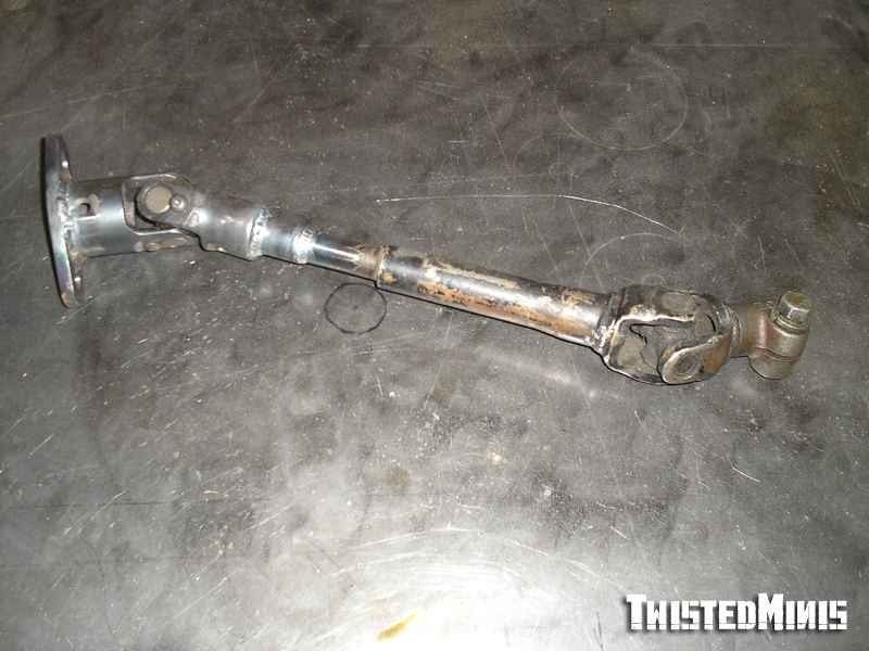

TwistedMinis's avatar
TwistedMinis
Basically, put some U-joints in the steering shaft.
