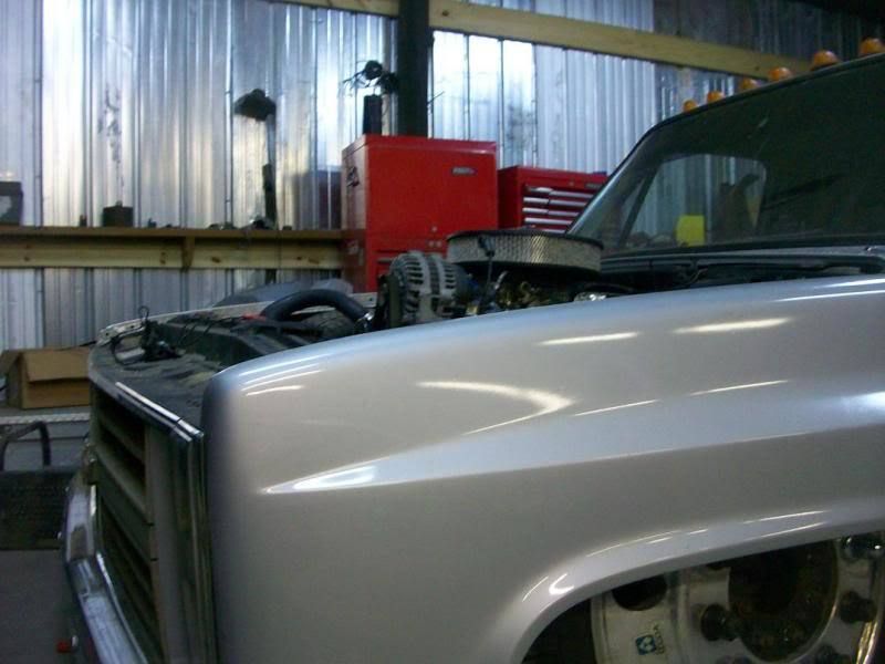

cubicdollars's avatar
cubicdollars
Check out my Square Body Cummins swap. There is plenty of hood clearence but not very much firewall,tranny tunnel clearence.
