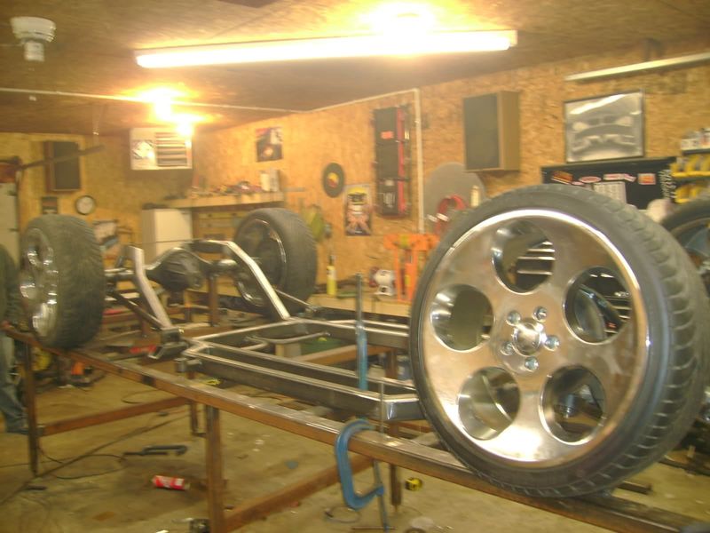

hey guys thought id post up some pics.. been workin on this for a lil and time to post up some pics...

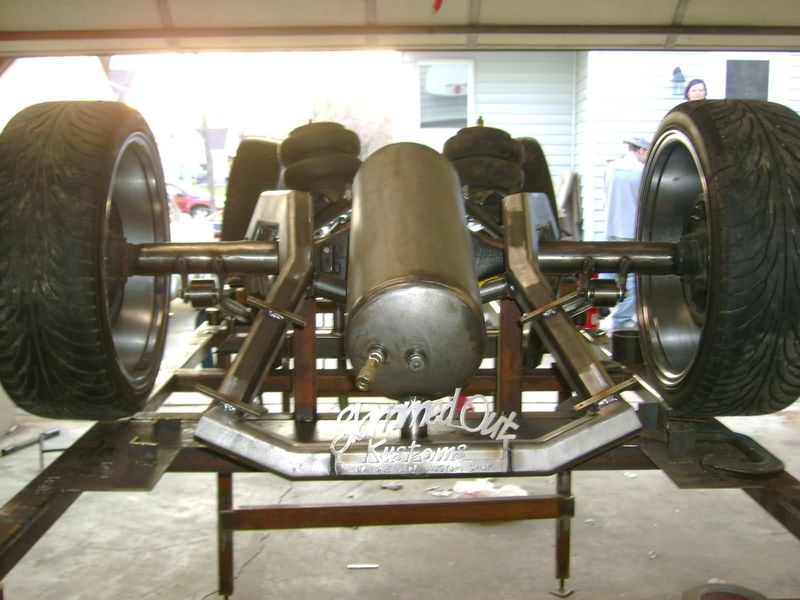

1st off the frame looks great awsome craftmanship...
but just a word of advice .. i know of a few people with there bags on the upper angled bars as you are doing here... and its almost as if you were running just one bag... its gives tons of body roll and doesnt ride all that great...

Like rigo said, the way your setting up those upper lift bars will make for an unstable ride. If you were to reverse the triangulation and have it wider at the axle it would be a bitchin setup.

ya makes sense thanks guys.. were not forsure with wut we wanted to do with the bags.. but thats for the help.. prolly do a canti lever then..
