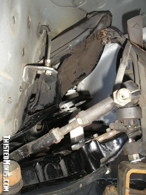

i rewelded my brackets about a 3/4 above the whole in the pic above is that enough space for my bags. it now lays out on the crossmember with some inches to go for the frame and the bags not completely flat
jdm customs's avatar
jdm customs
you want the bag to be completly flat when it lays, so you get as much lift as possible, also plan for bigger wheels if you want them or you will be rebagging the front. you do the lower mount first, then compress the suspension to where it is going to lay then put a 3 inch spacer on top of the lower plate then thats where the upper one goes. hope that helps, thats how i do it anyway.
jealousonezenvy's avatar
jealousonezenvy
the bags are crushed down. should get 3 inches of lift out of them atleast. i can always take my bottom plate out and bring it up more. i just tacked them to see if it would lay out
jdm customs
you want the upper mount as low as possible. i get 8.5 inches of lift with some 6 inch slams. the higher that upper mount is the sooner it will contact the upper control arm/balljoint
