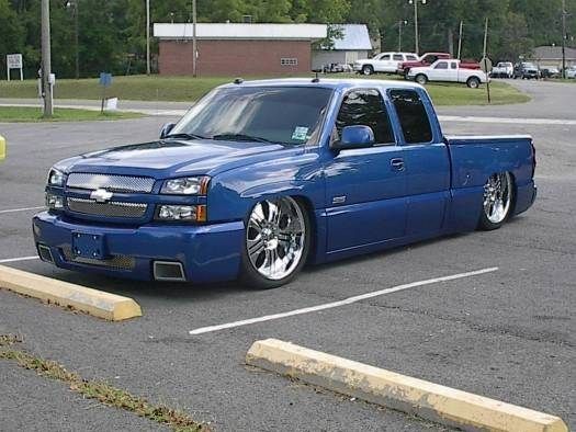

will the factory brake booster be ok?will a 24x10 with a +40 offset be ok?will I need drop spindles or control arms?

you will need to swap to a hydroboost unit, mini tub the firewall, relocate all elextrical and the coolant tank, loose the hood springs, and i would reccomend control arms and drop spindles, but thats just my 2pennies... it will depend greatly on what size tire you run, but those are pretty much the basics.
p.s. i hate the ride of shock waves, but to each their own...

24" no bodydrop
