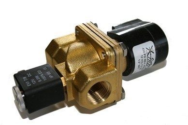

The GC 450 Outlaw is a unique 2-speed valve like no other on the market. With the combination of going fast or slow all built into the same valve body. Features
Available in 1/2" or 3/4"7.1 cv flow rate3/4" orificeFast coil from GC450Slow coil for Stealth modeSmooth and quiet valve in one package
I see this cheapest at Slam store:http://www.theslamstore.com/product_p/dsv-8-12.htm
