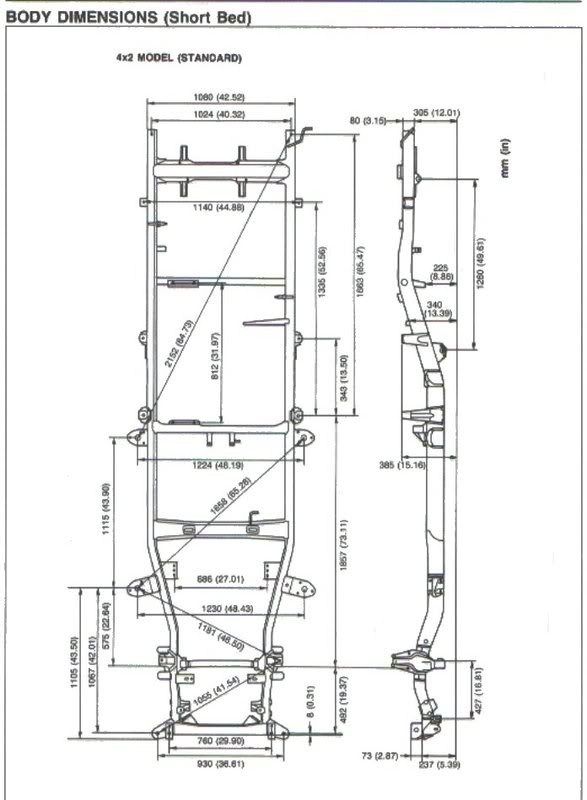

I NEED TO SEE IF ANY OF YOU GUYS HAVE INFORMATION ON FRAME SPECS FOR A 1986 B2000 STANDARD CAB SHORT BED. I'M GONNA BUILD A FRAME BUT I CAN'T FIND ANY SPECS ON MEASUREMENTS THAT I CAN PRINT OFF.
