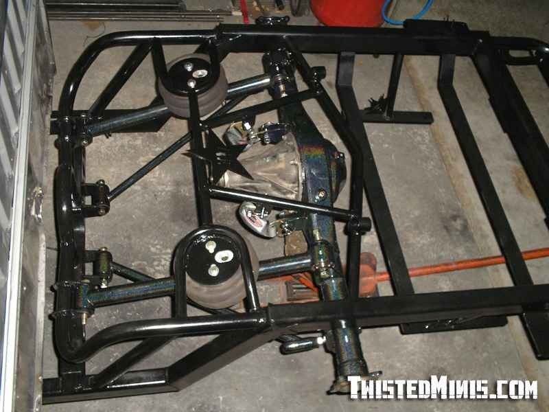

with bags on bar in this setup am i better doing them on the uppers or lowers?

I'm thinking it would be easier to put them on the top bars. The mounts being on the lower bars may affect the travel of the suspension. When I did this setup I put them on the top bar. Worked quite well.

any pics seth?

What are the negative effects of having the lower bars triangulated to a point below the pig?
I'm not sure what you are asking.
I guess I should have said "are there any negative effects from a systems like this on a street driven vehicle?" Will it make the vehicle unstable at high speeds, induce more or less roll steer, anything like that?

Almost everything I have read about them suggests using a rear sway bar.
