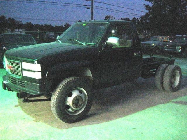

My '94 3500HD (yes, heavier than a regular 3500 by a long shot) scaled at 5300 lbs - with no bed, no interior other than the driver's seat, dash cluster sitting on top of the steering column support, and the door panels, no bumpers, didn't even have exhaust. 5300 lbs, when it still looked like this! :
