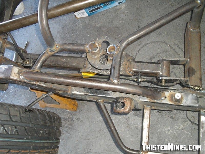

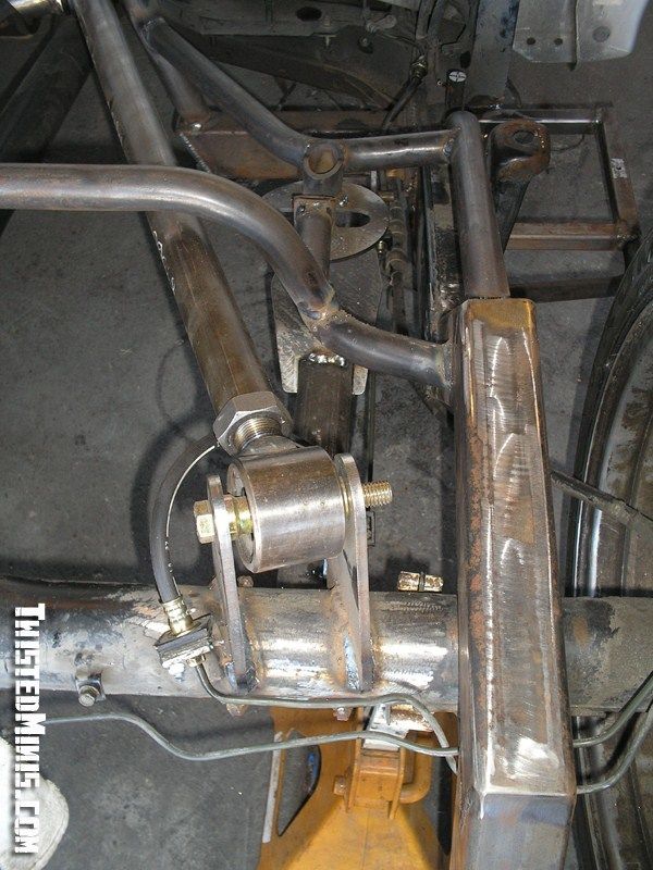

anyone know of a longer rear brake hose for the mazdas? i have ALOT of lift, and the stock line wont reach. besides a custom line, any ideas?
TwistedMinis's avatar
TwistedMinis
You can go to the parts house and get pretty much any length line. All you need is a female 10MM brake fitting on each end.
Heres another idea if you are up to it. I got an extra stock line, and shortened the hard line so I could use the flex line to attach to one of the link bars. Then I used the brake lien tubing I cut off with a new flare nut to make a hard line that secures to the link bar. Then another flex line that goes from the link to the axle. This way the brake line travels with the axle, and no binding. Here are pics.
burnoutboy1982
thanks dude. im gonna end up running it down the link bar. well i guess im off to the parts store.
