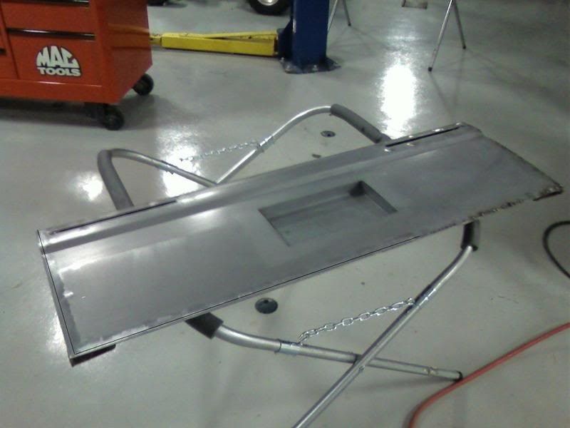

Na they havn't changed. A Grant skin does not work like a normal door skin. They are made so that you cut your skin off about a 1/4 from around the edges then cut the grant skin to fit in where your old skin was. they work great and when done right you dont use any filler. Here is a pic of a tacoma skin i done with out using any bondo.

Thats exactly what I was looking for! Soon as my Duramax gets outa the shop for the solid front axle swap Im doing a shaved tailgate and rollpan on it its all a 2007.5 new body style too hopefully itll look sick.
