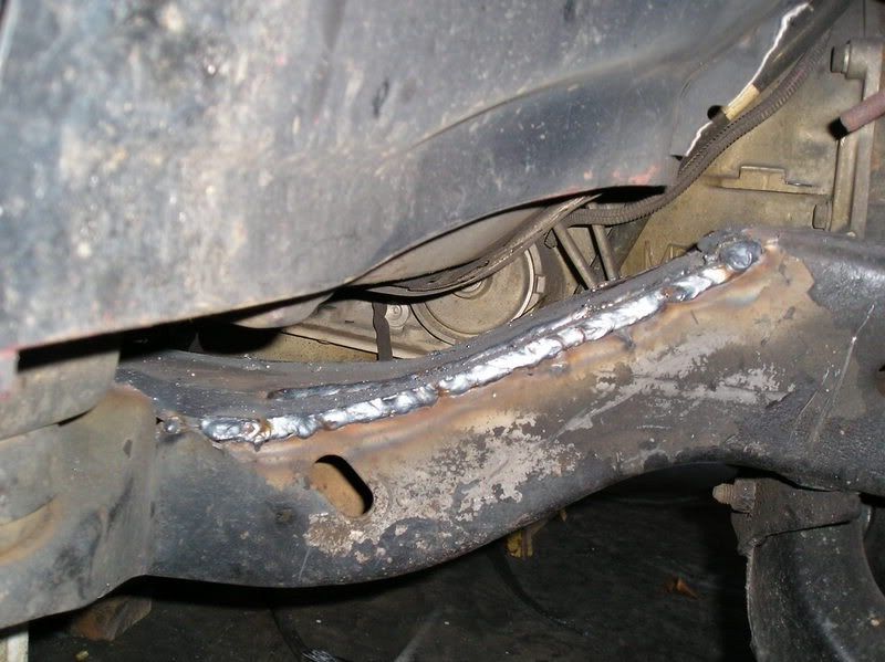

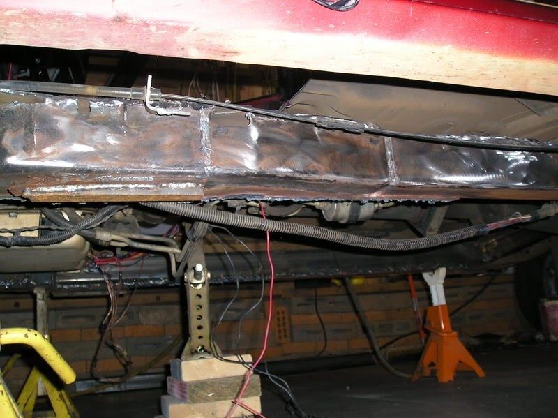

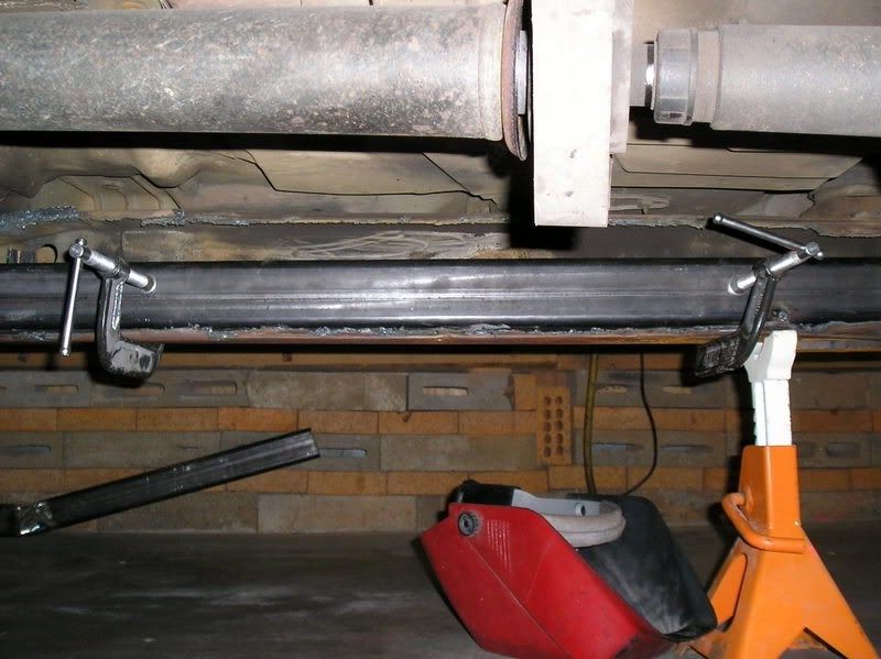

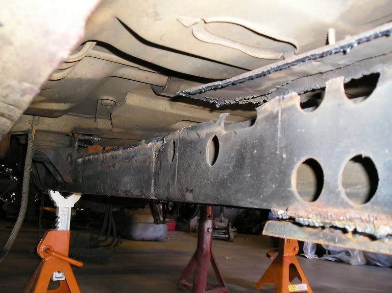

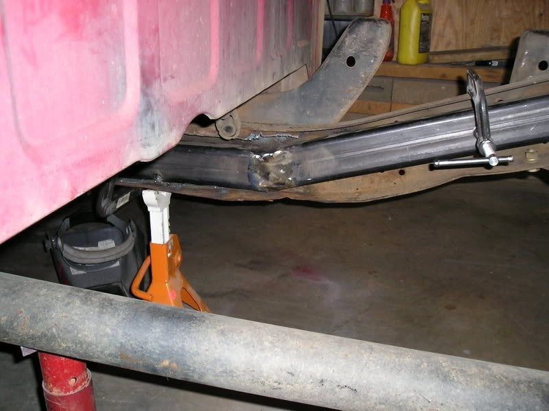

for the jis.. cut the stock cab mounts and lower then the desiginated bd amount. mark up 2.75 from the bottom of the stock frame upward, then cut at that line till just after the firewall.. stick the 2x3 in the frame and it gives you a nice spot to weld the stocker to the new 2x3. from there i am sure you can figure it out.

hey give me some time and i will get ya the pics from were i did mine.use the 2x3 for the frame and u can use the 2x2 for the crossmembers. but i will give you more detail when i can get my pics off of one computer to put on this one.s10dragn - Photobucket - Video and Image Hosting there is a few pics in my photo bucket so fell free to check it out. send me an email back so i dont forget cause i been busy trying to get that thing back on the road along with my daily car. lol yeah it sucks both are down at the same time.
