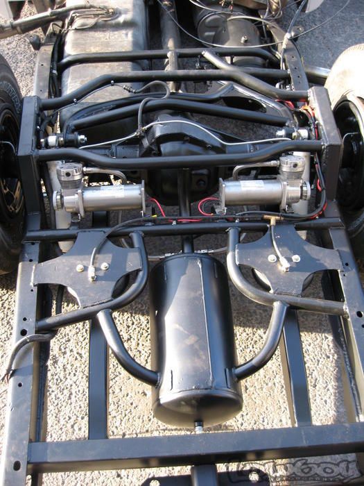

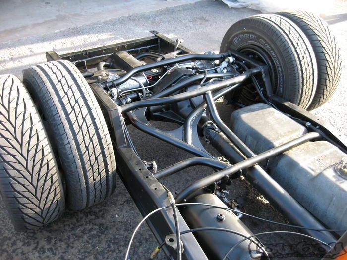

Moveing the tank isnt required. Narrowed or c&c axle. Run a 16 on the inside. Move your lower link bars below the frame, upper link bars between the frame.
