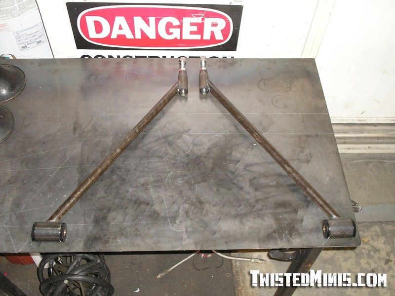

I build all of mine, and I prefer it that way. I don't think its hard, and I like building things that SD doesn't offer.
Stuff like that, wouldn't be that cheap from anywhere really. Easier to do it myself I think. But I build links for other people too so...
