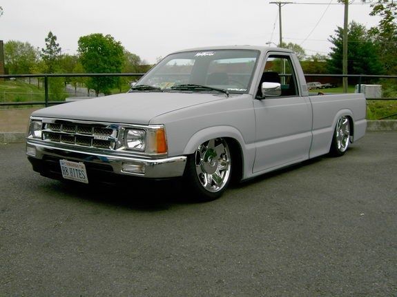

Anyone know of any major issues with 18" Escalades on a layed out Mazda? Better yet, anyone got any pics of one cause I'm failing at it.
Check my profile for pics of the truck.
These are the wheels
W
Wody
I would like to know if they need to be bored out like the 17's needed. Will they bolt up with out rubbing? Any clearance issues?

they have to be bored and they will tuck, just roll your fender lips
BrandonDXC
never tried the 18s, but here are the 17 inch versions on my old truck, layed hard with stock spindles
dfifty
i think there an inch wider then the 17's and the same backspace so they will stick out 1/2" more something like that but the do stick out a little further.

they will fit if you have 4x4 sheetmetal. otherwise you have to flare the bedsides and pull the front fenders out a little.
also, on a mazda, one can simply grind the tabs on the hubs and drums that keep the wheels from bolting up, without having to get them bored out.
