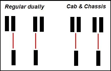

Also don't forget their main usage: chassis cab trucks. You probably already know this but it's dead easy to tell for sure if it's a C&C rear; the front wheels line up with between the rears, instead of the fronts being in line with the inner rear. Hope that makes sense. You probably already know this but just in case, figured I'd say it.

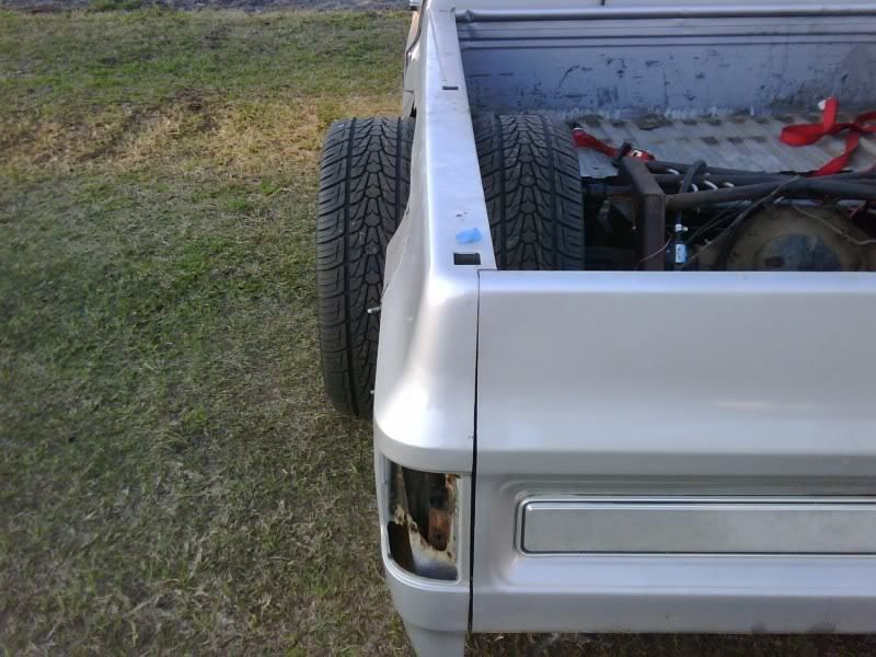

comegetsome's avatar
comegetsome

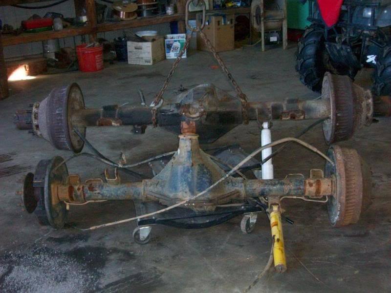

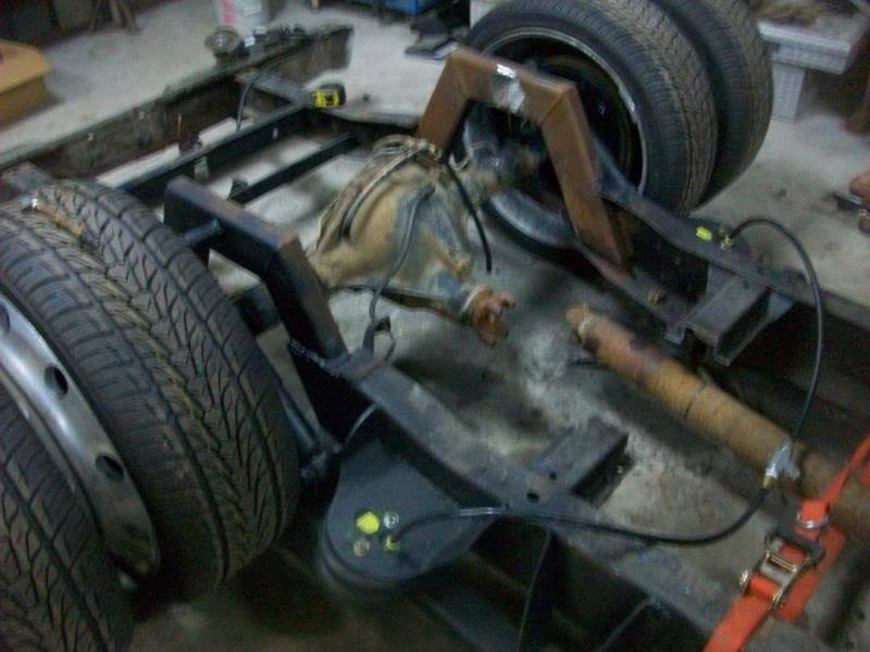

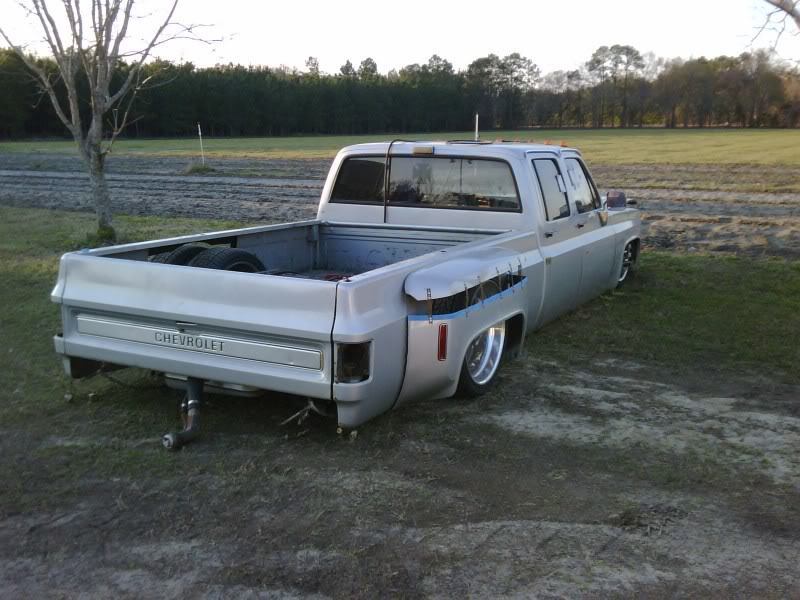

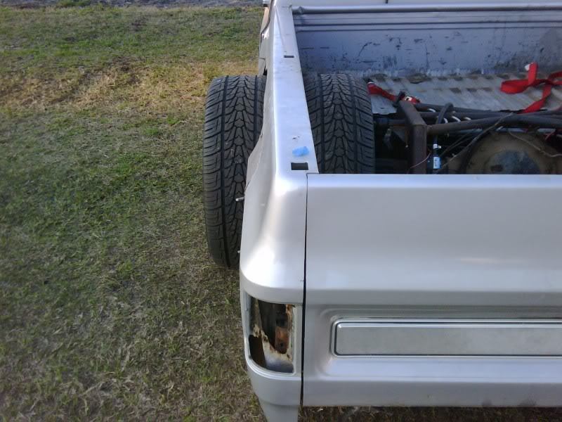

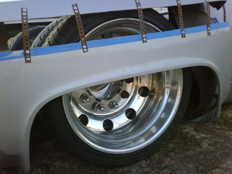

i used a SRW rear end out of 98 model on my truck and it worked out good...but im running 6 semis instead of 4 and steel inners and since mine is bagged/bodied i didnt have to worry about spring perches...here a few pics so you can see how that rear end works with semi wheels on a box
