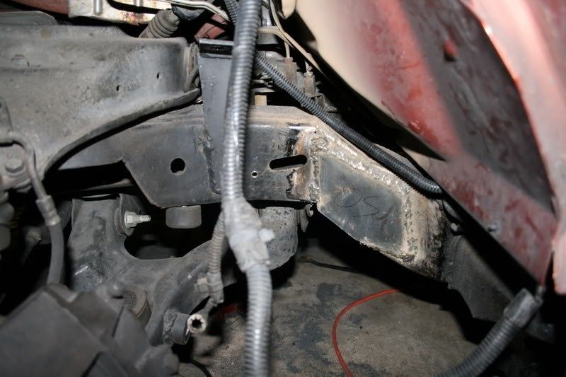

Here's a pic of part of a z. Not the best but it was all I could find at the moment. I haven't done mine yet.
Basically, you cut the frame in front of the firewall (both sides) move the front section up however much is needed to make the x-member even with the rest of the frame, then weld it back together and plate the shit outta it. Then cut the frame horns in front of the x-member and move them down the same amount you moved up. Weld it and plate it.
