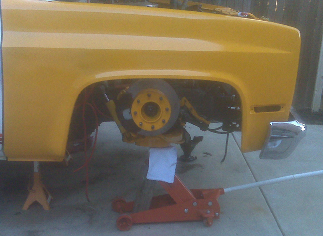

sorry to thread jack.... but how many inches did you sink the cup in your lower a arms?
olsskooltandem
3"....maybe different for everybody, but i needed the 8" bag to sit all the way in the pocket.
