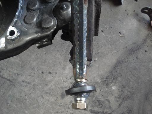

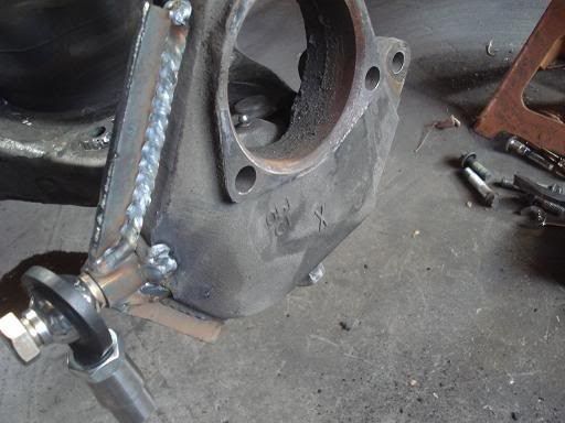

well just droped off my spindles well a set i had laying around should have them back tomorrow evening!
( good thing my sisters bf has a race car/fab shop ... )

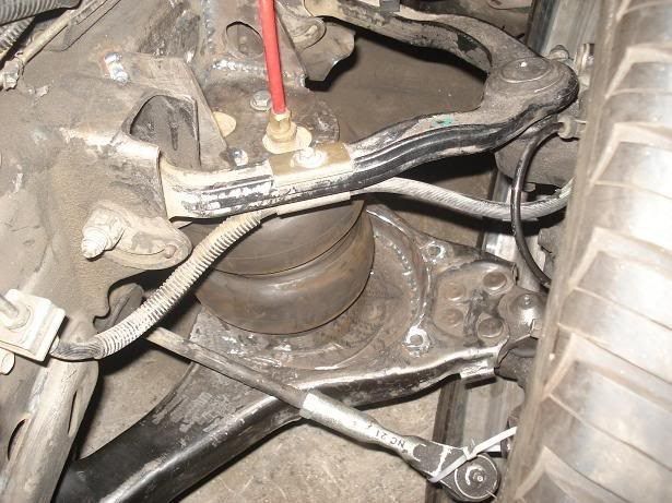

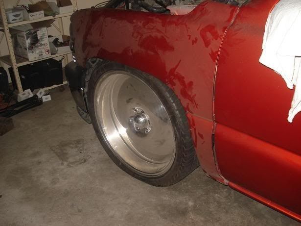

ill post pics when i get off work but its a 01 silverado with stock everything including spindles
i modified the frame so the arms will swing up higher but there mounted in the stock spots and it has stock spindles
everthing is 100% stock
this is 100psi

how did you get so much travel out of the upper ball joint?
stkflrd73's avatar
stkflrd73
its working but im going to have some uppers built before i try driving it everyday again but there it is and it will go more 2in maybe
