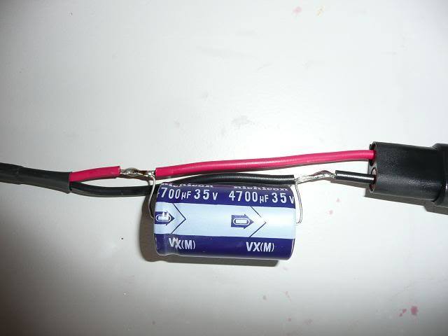

Yeah, In my Chrysler I had to use a capacitor to help regulate the voltage. Among the kits i have purchased I have found this to be inconsistent. Out of the three kits on my Chrysler only my low beams needed them. Even though the ballast looks the same something seems to be different in the internals.

This is how to do the capacitor trick.
Note, the arrows on the capacitor point to the ballast.
