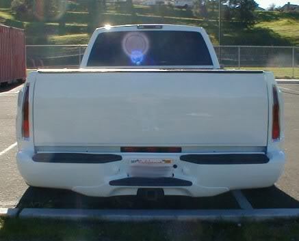

Well after serval hours later we have shaved tail lights Thanks to John Boreli(Dually Scene Member).He took his time. He made sure they were done right!Clean up some other B.S I had going on since truck did have caddy lights as well. He even thaught my step son(8 years old 2nd grade) HOW TO WELD

How do I wire 3 wire led strips in to the stock harness? Does anyone have the gm tail light book for the 98
I no that harness is tricky

Here is the mess
I know that
yellow=left turn signal/brake
dark green= right turn signal/brake
brown=taillights/tag lights
light green=reverse
now were do we go now
giovanni's avatar
giovanni
Ok have them All wired in there so far they work and look great will take some pics this weekend
