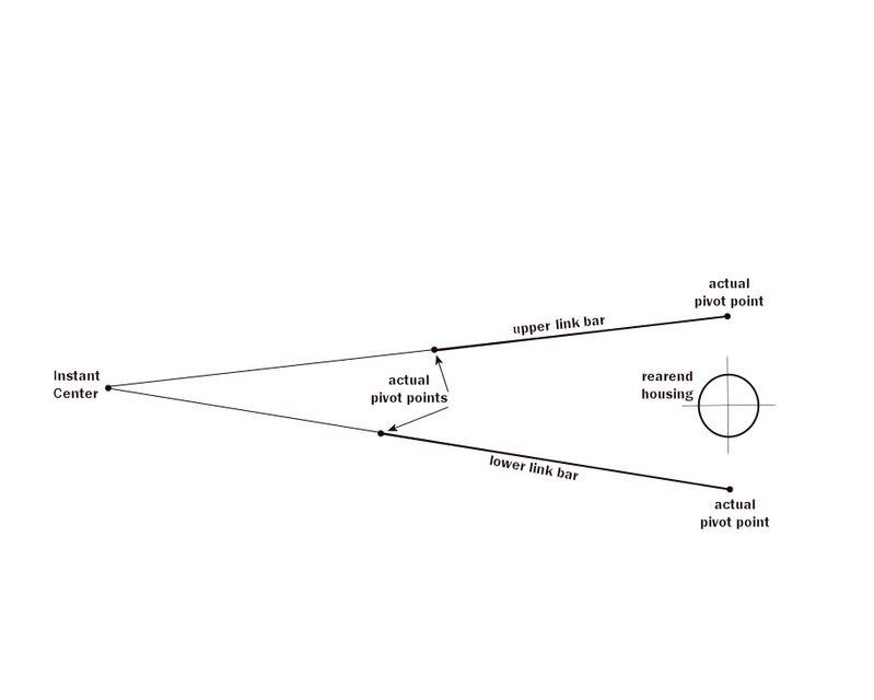

I would prefer you left them where they were stock, and just angled the ball joint. But I can't even say if they are in the right spot now. Because if you start moving things around it will start throwing everything off. You will change the instant center of your suspension, which is where the imaginary point of your upper and lower control arms intersect. Much like the rear instant center.
Second, the main pivots in your suspension need to be aligned. Your UCA, steering, and LCA pivots, like in this diagram.
I can get better diagrams if that doesn't make sense, thats just all I could find on my computer.
