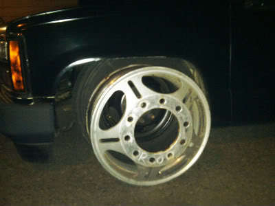

Oregon people - I need my Semi wheels shoveled down... Where can I go to get this done and not have to spend an arm and a leg on shipping? All of the machine shops in my area are 75 per wheel... Seeing that lock does it for $25, i feel like I am getting raped!
lockone's avatar
lockone
You can send them down here. I have a lot of customers in the Northwest that send there used wheels to me. I just received and sent out 3 sets from Oregon, Washington, and Idaho this week.
You are a bit short on the price for my machine work too. My price is $150 per wheel for 4 wheels and $125 per wheel for 6 wheels if you send them to me. You may have misunderstood our shop manager if you called for a quote in the past few days and didn't talk to me.
Also not many machine shops are capable of performing the proper machine work to the wheels correctly. Just spend the money right the first time. I have replaced several wheels other machinist have botched trying to do the work.

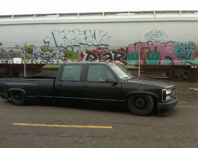

Nice truck also!
