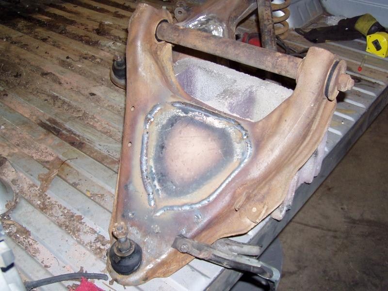

i just used a plate on top and plated the lower control arm flat. no cupsat all

got pics of any?
jrhall19
There is a pic of my control arm on my profile.

here ya go, jr

I am not really sure plating the lower arm would help much. The bottom of my bag looks like it would be below that plate, since we cut the cup way down.
