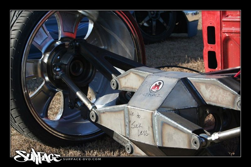

Max, if i may be so humble to ask what gauge is that metal and is the whole frame built from it? and if so did u internally gussett or being so much of it is it just strong being welded together?

The metal is all 1/8" cold rolled mild steel. There isn't any internal gussets because it is very tough the way it is.
Most everything is drawn out on poster board in all 3 dimentions to eliminate as many unforseen issues before I build.
The bandsaw is a basic JET wood saw with a reduction kit installed... I really wish I had a better one.
