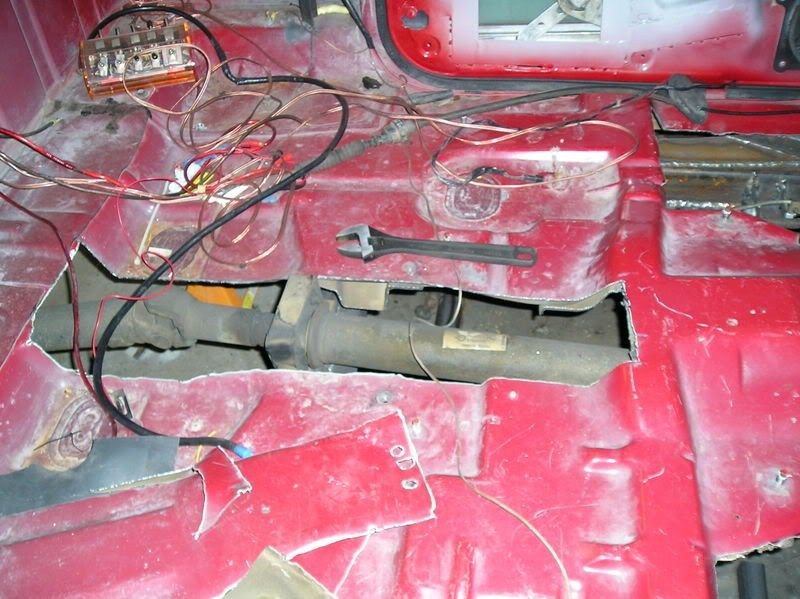

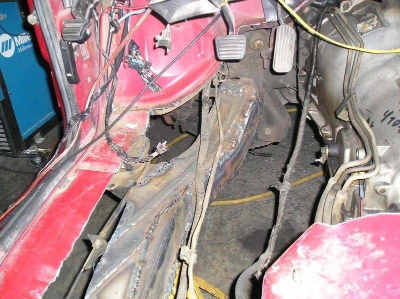

MagicMikey's avatar
MagicMikey
here is my ext cab s10 were i cut it out.
