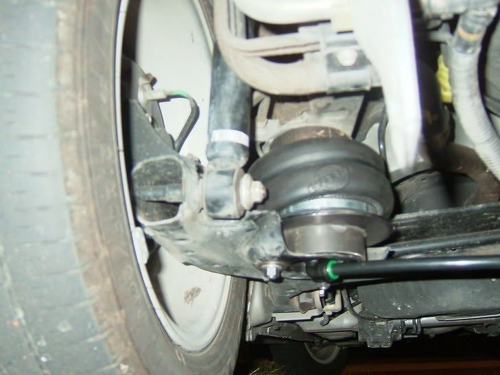

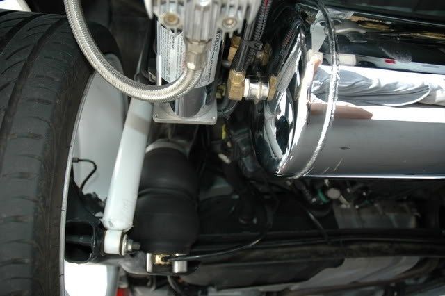

we used the fbi rear brackets for the rear and the universal kit for the front and it was super easy to install.

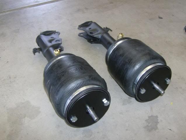

I have a set of bolt in fronts from a customers car that I just want out of my shop...they get big lift, and ride not too bad.
bdsonoma
we have used the AirLift kit a few times at the shop, lays good, with a decent ride.

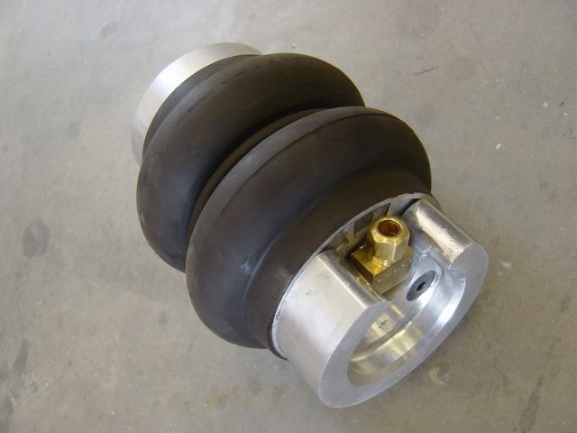

I dont like the rear brackets the put the line on the bottom of the axle, you can make a bracket to fit a 2500 pound bag that has the fitting on top of the bag, and away from the road. You have to slightly offset the bag from the center of the upper mount but it can be done, and you have to use a short fitting, of the compression type. I built mine to be 100 percent bolt in too, and it tucked a decent amount of tire in the back.
gravity5's avatar
gravity5
Oh I ended up having to use bolt in camber plates in the rear, due to the tire hitting the front of the fender as the axle pulled forward, you can buy them online...let me find a supplier for you, they give you about 3 degrees of negative camber on the rear by bolting in between the axle and the hub.

Maybe on a 16. but with 18's the tire will pull too forward in the rear, and hit the fender, and in the front you need to raise the strut tower.
