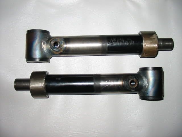

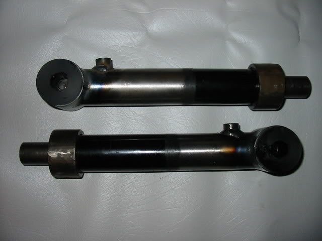

We welded up some cylinders last month for a guy doing basicly the same thing you want to do. It was for a honda car. He wanted the cylinders notched and 2" 1/4"wall d.o.m. welded to the top, so he could run a poly bushing(like 4-links) we also shorten them some for clearence problems he had. I Tig welded the joints but you can Mig weld them and be fine, just pressure check it for leaks.

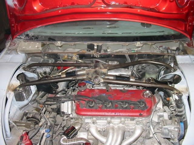

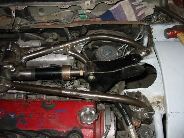

heres the pics, the cylinders BLF is talking about were for me...and they kick ass
and my set up runs horizontally over top of the head and fuel rail
