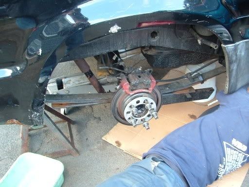

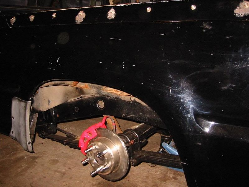

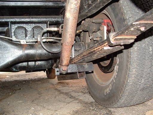

I have a few Toyota rear ends in leangths of 55" from WMS-WMS and 57.5 WMS-WMS...we machine the axles to the common 5x4.5 bolt pattern, and install Mazda Rx7 Turbo Rear brakes...billet brackets to hold the caliper..
this is my daily driver B2000 with a rotary engine
