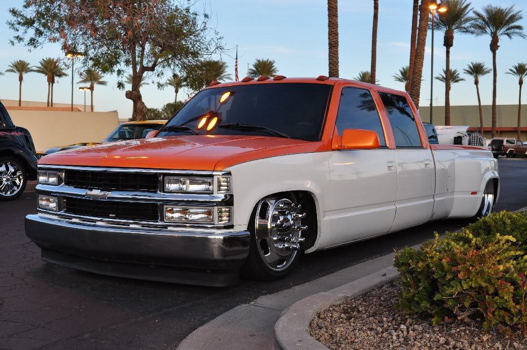

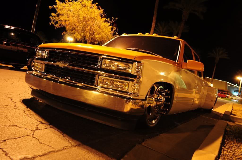

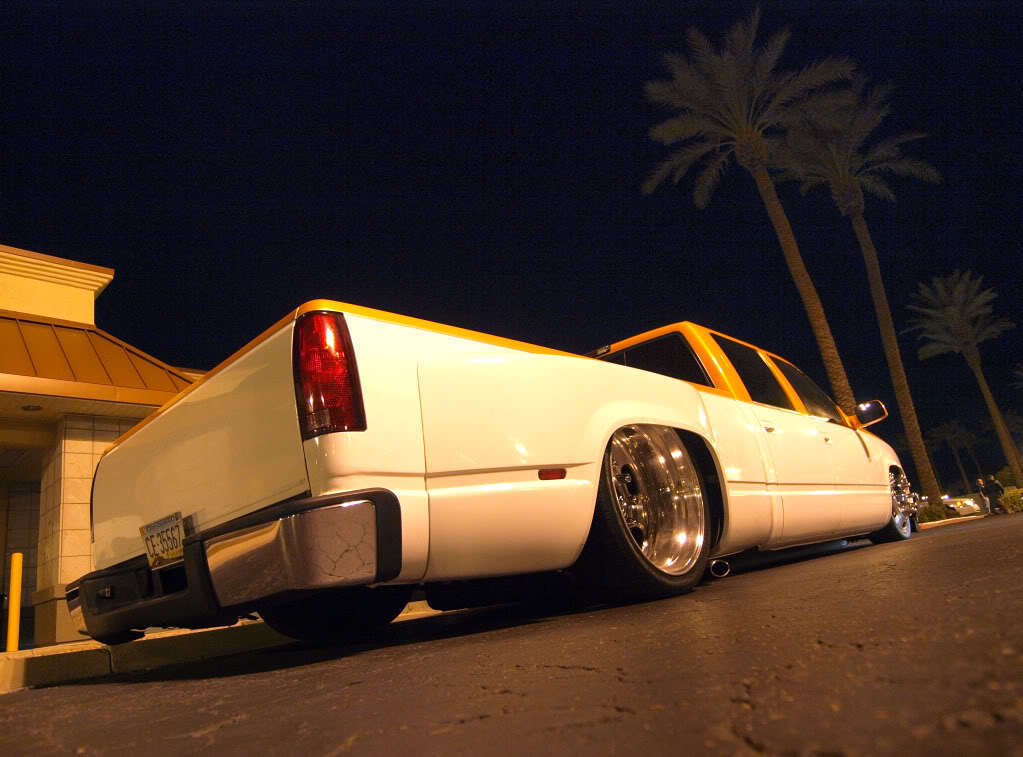

Havent had it aligned yet, but the new arms make it look awesome (my opinion)...Love it! All heim tie rods and a new steering box...she is nice and tight. Thought I should share these pics

man! looks killer! so, you swapped to single 8-lug hubs to pull the wheel in, and these arms are a bit longer than factory arms, so they push the wheel centerline back out, right? pretty effin cool...

yep...the 3/4 hub pulls the wheel like 6 in and then you go about 3 longer than stock and now it tucks, clears up the camber issue and gives me a lower ride height.

sweet deal.. did you get to keep your front sway bar? also, did it help your turning radius any while riding low? finally, would you be willing to share how much the setup cost? (im me if neccesary).. sorry for all the questions! thanks!

yup could steer lower. I have my sway bars too. I think it was like 1200. Not too bad for all the work they take as well as how much better it looks and drives...

Are you running a spacer on your front wheels?
