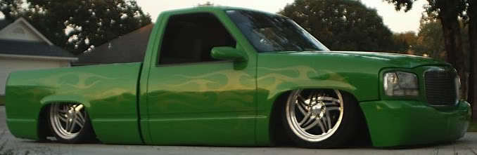

I bought OEM-type clears for my setup many years ago...off eBay. Probably still find them if you hunt enough. This is my old '92:
Richard

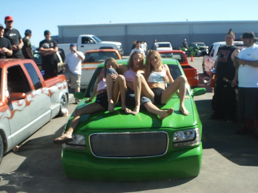

i made my own backk in 00 when the frontend first came out
i just cut the back side with a die grinder right where the lens and housing go together and "plasatic welded" them back together
snapon has a plastic welder thats basically a overgrown solding iron you can put a flat tip on to heat the plastic back up and melt it togther.
and heres strippers on the hood jusst cause pics with strippers are always more fun

i will call tenn. got the num. thanks if cant find try cutting [ love the strippers]
98crewcab's avatar
98crewcab
I want some strippers for my hood !!!
