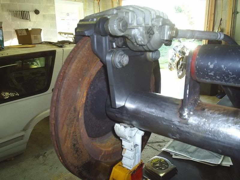

Make one like i did...
jsondrops's avatar
jsondrops
damn Dubs thats a pretty good idea!
i bought a rear axle out of a 00-06 silverado for my yukon with everything on it for used for 400 bucks.i had to buy new brake hoses and it all bolted up fine.
so i got about 450 in mine.
9.5 ring gear 10 bolt axle.

Originally posted by xinsertnamex
Make one like i did...-------------------------------------
What all was entailed with that conversion of yours?
