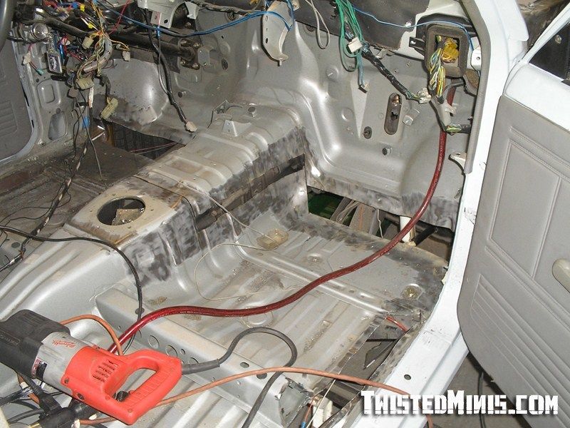

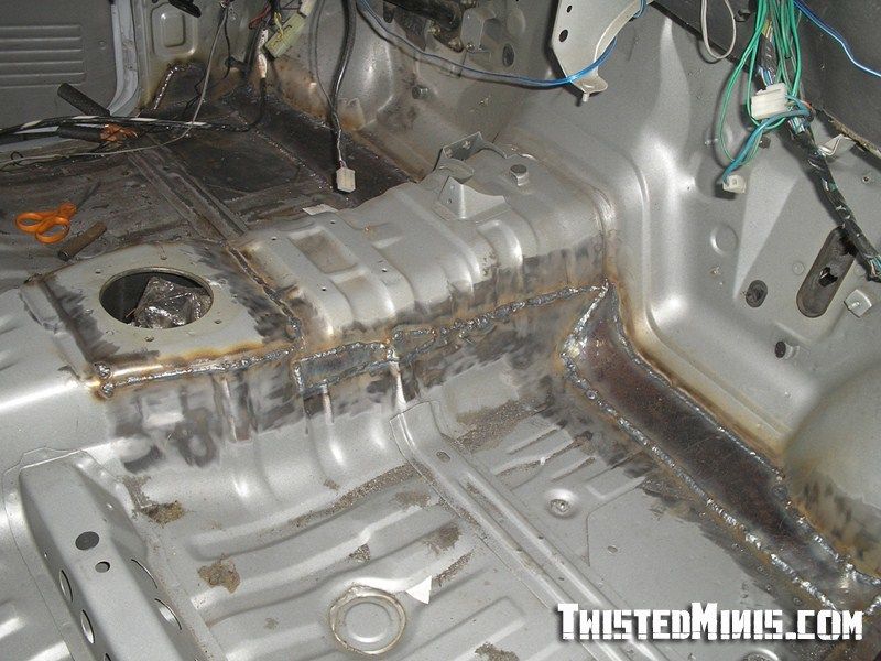

I cut the transmission tunnel and lowered it. Theres about 3" of room between the transmission and the tunnel.
Everything fit back in like I didn't even touch it, except the carpet. For that reason, and headroom since I couldn't fit back in that truck, I like the stock floor idea. It looks like there is enough room under the Mazdas to stock floor it without cutting the floor in any area.

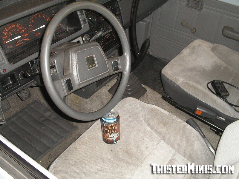

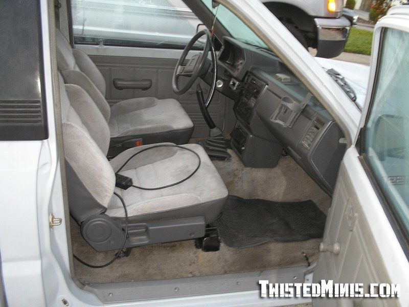

Originally posted by s-10freak
hey seth do you have any pics after you put the dash & heater in....not that i dont trust you.......
These are the only interior pictures I have.
