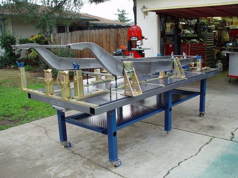

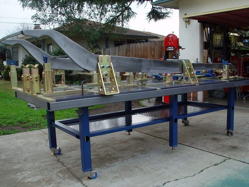

Here's a pic of ours. A little over-engineered but very user friendly. Definately something you would use for a long time. The top deck is 5/8 tooling plate surface ground and anodized, there are 5/8 steel rails that are tapped every inch so that everything bolts in place and then you tac weld the material to the upright. There's also an engine cradle that rolls foreward and back on runners to keep the engine centered and squared. There are also leveling legs inside every leg so that the table is mobile and also very easy to level.There is a hot rod chassis on it in the picture but we're currently building a full air ride tube chassis on it that will lay out fully when complete.

damn all i have to say on that table is damn thats nice.

Wow. Did you build that, or buy it?

Thanks guys, it works great too!
No, not IF Customs.
I didn't personally build it. A friend of mine, Joe Iacono (automotive artist, joeiacono.com), his dad Carl built the table.
