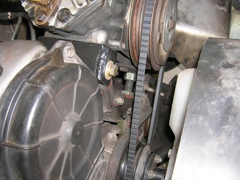

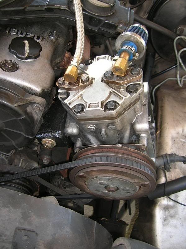

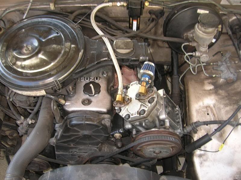

heres how i did mine,
i took off the smog pump, and cut the bracket down,
then i plugged up all the things on the engine that came from the smog pump,
and i made a simple bracket, to hold the compressor where the smog pump was.
and then i made a way to tighten the belt, and bolted it to the bottom of the york, and it pushes on the old bracket for the smog pump. it works damn good!
you can see it by the belt in this picture

well thanks alot .. where did you get your parts and about how long did it take you ???
blazed22s's avatar
blazed22s
the metal was just a piece of angle, i think like 3"x3" that i had layin around, and the bolt was from tractor supply.
it took about a day, but i take ALOT of breaks haha. and alot of test fitting and such to make it not hit the valve colver and timin belt cover. other then that it was pretty easy. the bolt on the bottom set up is pretty easy also.
its basically a nut welded to another peice of angle steel, which is bolted to the compressor, and then a bolt and jam nut were put in place.
