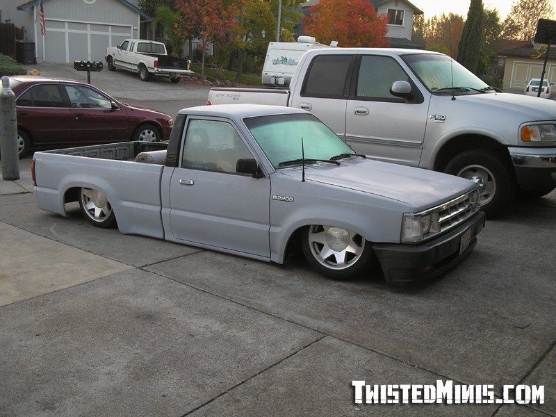

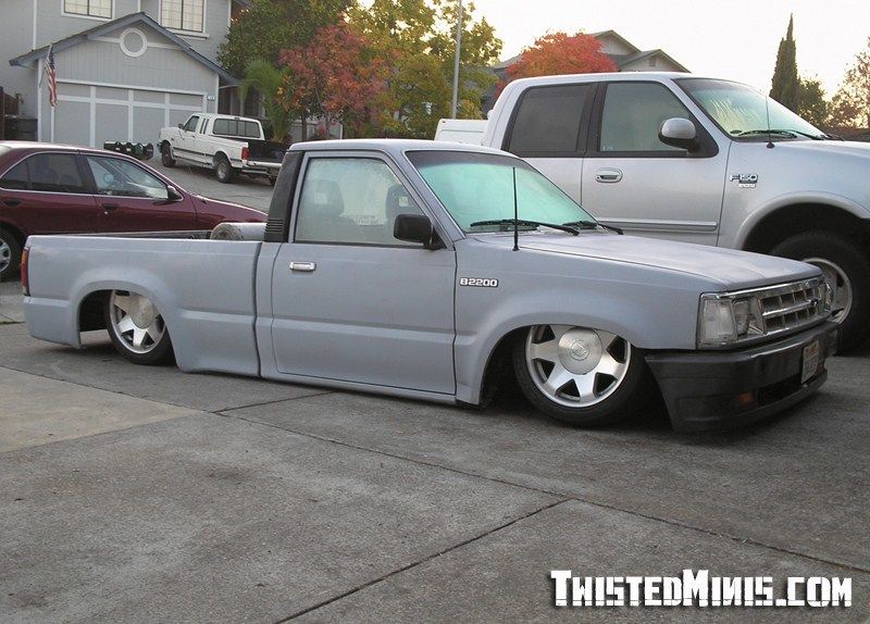

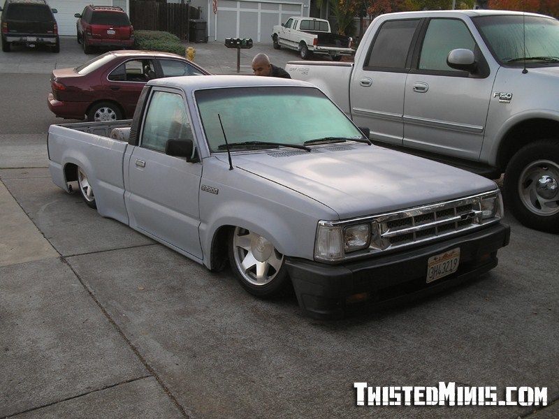

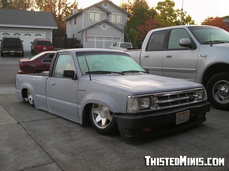

Literally, about 15 minutes ago rolled it outside. I will take better pictures in the morning.
Lays rocker, but needs a little dragging because the front crossmember is plated with 3/16". 4WD fenders are cut to match the rocker, and the rear bedside is rolled up. The rear wheel isn't forward of center, the axle is just narrow and it looks weird...

Nice, good work. Between this and your toy I may have you body drop my suzuki.
looks great seth......why did he decide to go with the smaller rear end
dragginmazda86's avatar
dragginmazda86
Looks great man, time to go drag the front crossmember.
Stock axle rubbed the bedside just laying frame, and the bed gets narrower at the top. It needs a 1" wheel spacer on each side to be good, but it will do for the drive home tomorrow.

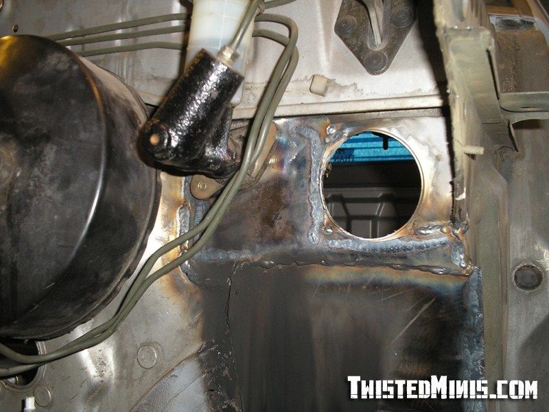

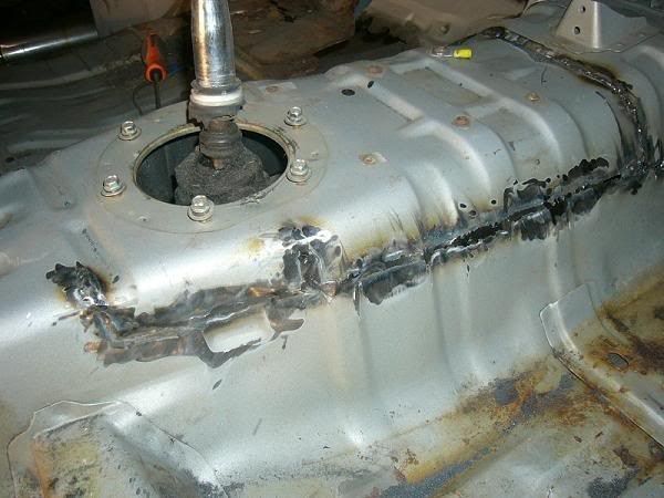

Where are the "in progress" pics?
TwistedMinis's avatar
TwistedMinis

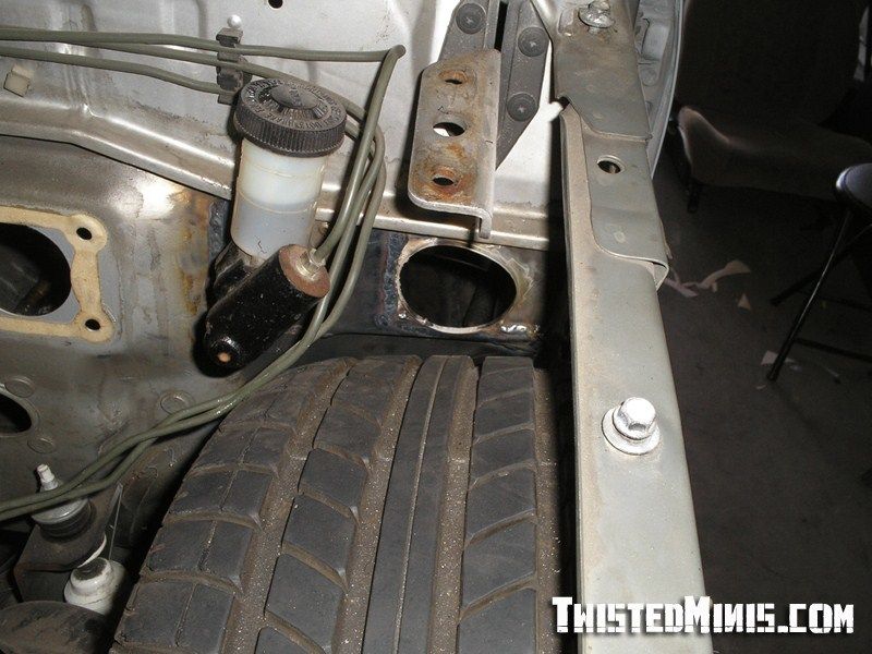

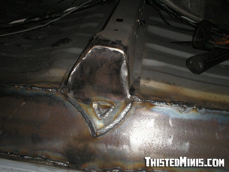

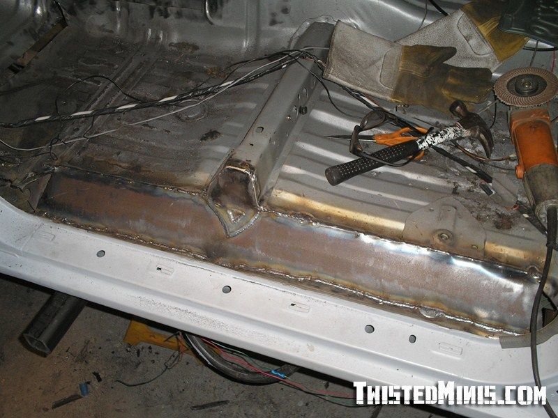

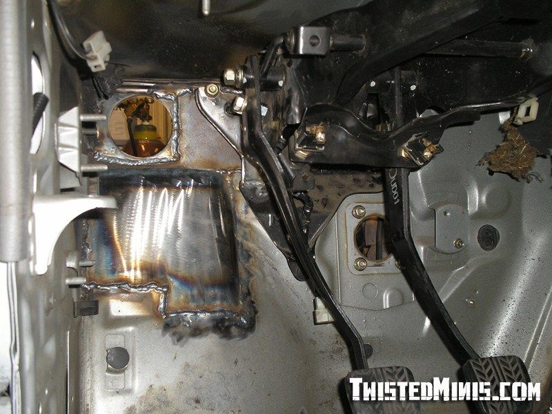

In the profile.^Brake lines got moved.

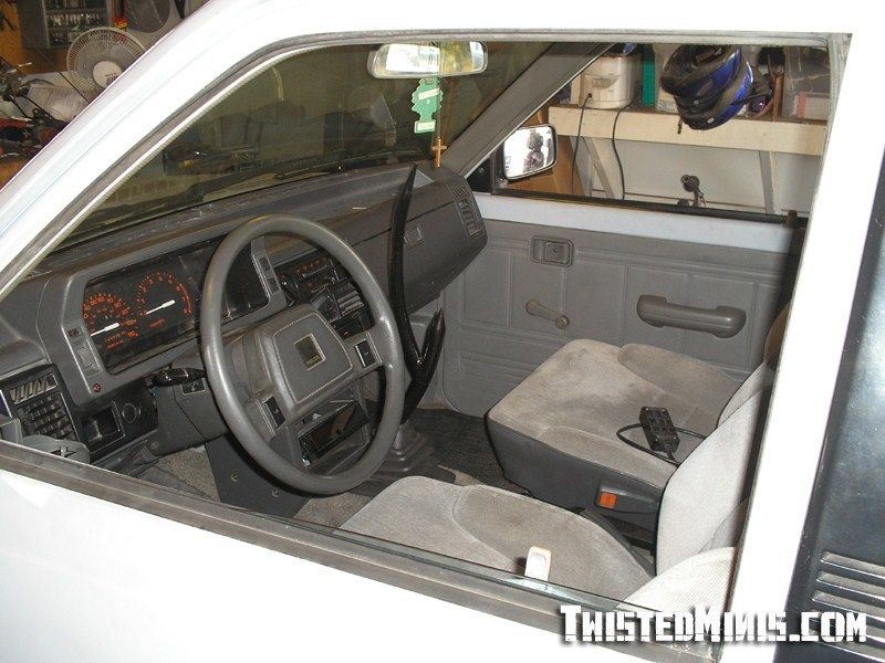

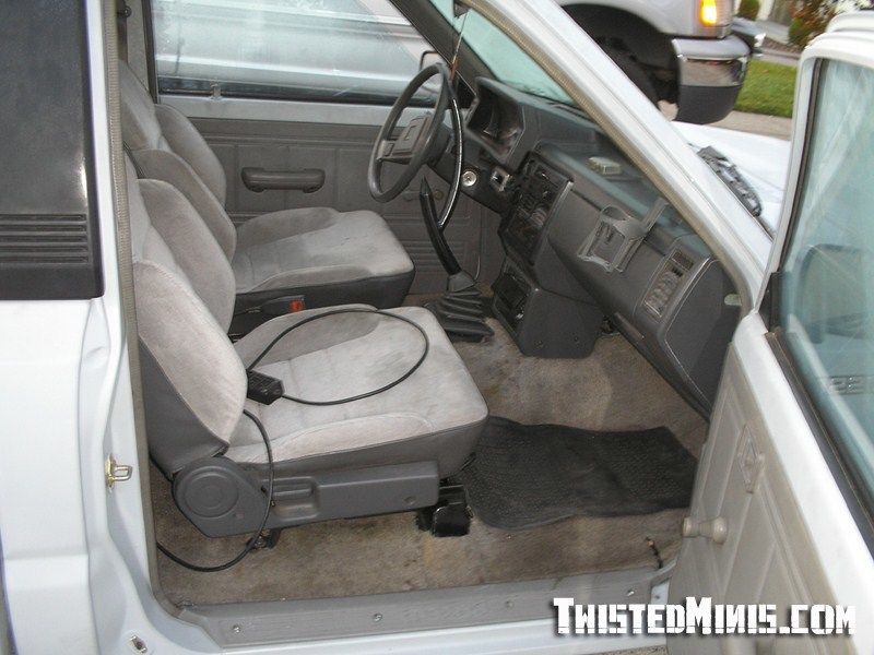

Interior looks pretty much stock.Except for the fact that the buckets are really tall and theres not much room.Soda can doesn't fit under all the way.
