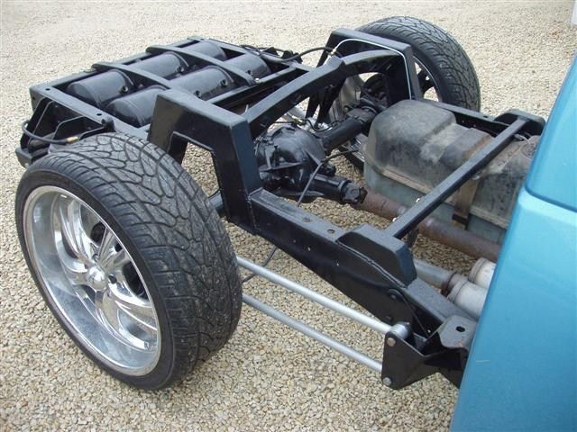

LOL- can't help you there! The upper bar on this xmember is stout enough to weld some new tabs to, if you're feeling brave... good luck either way!

do i see a bolt on brakets and link set up in those pics for the ck/s? u got more pics of the set up? looks pretty kool

Keen eye!
We're working on a new rear setup for these trucks that should be pretty neat. Actually, it's two different kits- one that's a wishbone link, and another that uses ladder bars and a Watts link. Still got some more fab to do, but I'll be sure to post it up when it's ready for prime time!

Have you had the box on yet..?
I built one a few weeks ago (similar idea) and had it what looks to be about that high. I ended up having to add a new piece to drop it down because the fuel lines were hitting the bedfloor.Its too high in this pic..

with big whheels will the driveshaft hit it? or when ur riding with the front high and the back low - cali style i guess its called

same problem with mine, i raised the tank up 1 inch but now the lines hit my bed and the back still drags the ground.

I raised mine just enought for the shield to clear the frame and had to cut the bed for the fuel pump and lines.

We'll get the bed on today for final fitting. Our measurements show everything clearing, but you know how that goes- you never know for sure until it's all bolted together!
