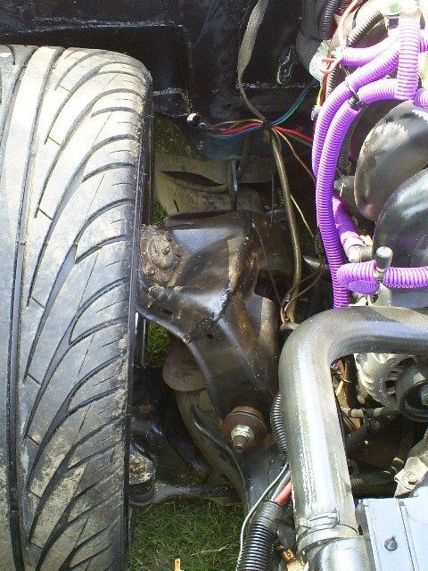

ive got two s10s both somewhat stock arms. the lowers have to be dehumped & the lower ball joint stepped upwards. the uppers have to be pie cut for truck to lay on 20s.. there was an article in street trucks a while back. youll also need drop spindles heres a picture to kinda give you an idea..

both my s10s lay 20s without any mods to the uppers and only dehumping the lowers i didnnt have to notch for steering either but i do have long travel ball joints and spindals
