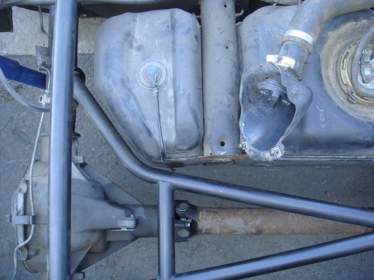

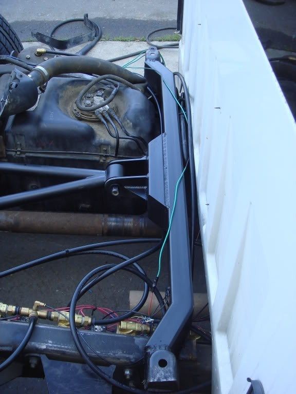

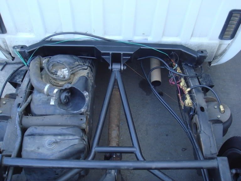

I just used the stock tank on an 02 silverado. raised the rear crossmember i think 2 inches, and then made a new crossmember for the front.. i have about 1-1 1/2" of clearance when laid out...
