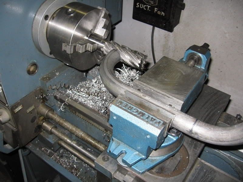

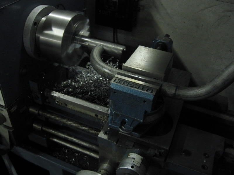

rizz0's avatar
rizz0
lathe?????????
BuiltByBrooks's avatar
BuiltByBrooks
no its one that uses a drill
