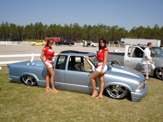

Heres a few pics of gil's s10 with 24"s all the way around:
And heres Ricos s10: It was for sale not sure if he ever did sell it.
Maybe this well help you.

Rico's truck wound up being parted out then sold for next to nothing. The Bed went on a truck that moved to Michigan & got drug to death(now destroyed) and the hood is on my truck (still in Fl).The 24's came all the way up to the top of the bedsides but did fit, I've seen it in person.

im sorry, i mis-typed the tire size... it's a 245/30/24... i have no idea what i was thinkin with a 245/20/24 lol... i've seen rico's truck before.. and i've seen the one from aftermath too... isn't gil's stock floored though?
i've seen pics of rico's on some 15in wires from a show somewhere in texas, i couldve sworn..
so, im guessing that it comes down to the height of the bed sides on a dime then? and i'm thinking now that i can run no wider than a 8.5 or 9 in in the rear with the right offest..anyone happen to know the height of the bedsides of a dime from rocker to rail?
